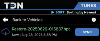

7. Find the vehicle you just read in the list and tap its name to open its folder. This screen contains a list of all the reads you have performed on the vehicle.
8. Verify that a green check icon appears to the left of the scan you just performed.
If the scan is listed here, but the green check is missing, it means the scan was successful, but the upload to the server failed. Follow these steps to resend:
a. Ensure that your phone has a good Internet connection.
b. Tap the SYNC FILES button near the bottom of the screen.
c. If the green check still does not appear, ensure that you are still logged into your account (go to the account screen and log in again) and then try to sync the files one more time.
