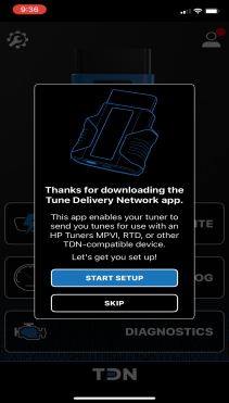

1. Once the intital download is complete, click START SETUP.

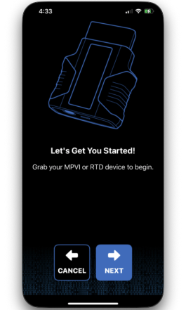

4. Tap NEXT. The app indicates that it is about to set up your interface device.
A picture containing text
5. Tap NEXT.

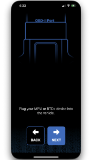

6. The TDN app prompts you to connect your interface device to your vehicle’s OBD-II port and turn the vehicle’s ignition on. Go ahead and do so.

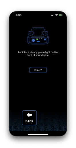

7. Tap NEXT and wait for the STAT light on the front of the device to turn green.
A picture containing diagram

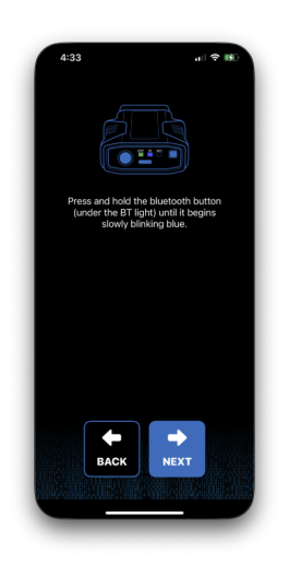

8. When STAT or PWR is on solid, hold down the button on the front of the device until the BT light starts flashing.

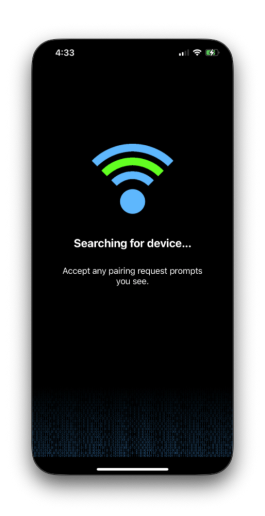

9. Tap NEXT. The app will begin scanning for compatible devices.

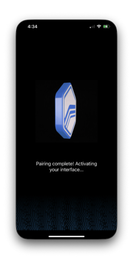

10. Once the app has detected your device, it will attempt to establish a Bluetooth pairing with the device. If your phone prompts you to pair with the device, be sure to confirm.
11. After successful pairing, the app will attempt to synchronize the device with the server.
Icon
12. When the sync process is finished, the app will indicate that setup is complete. Click Done to exit the setup wizard.

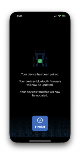

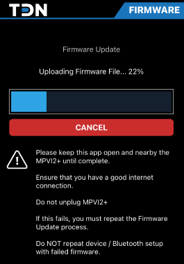

13. If there are any firmware updates that need to be applied to your interface device, they will be downloaded and applied now. Depending on the size of the updates, this may take several minutes. Be sure to keep your phone connected to the internet and near the device until this process is complete.
14. When all firmware updates have been applied, the initial setup process is complete, ensure to press Finish.

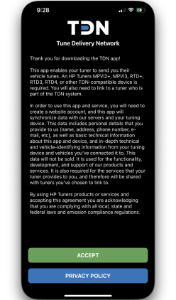

15. The TDN app will ask you to agree to their license agreement and collecting data from your app, click I Agree and Yes, Collect Data and click ACCEPT.
